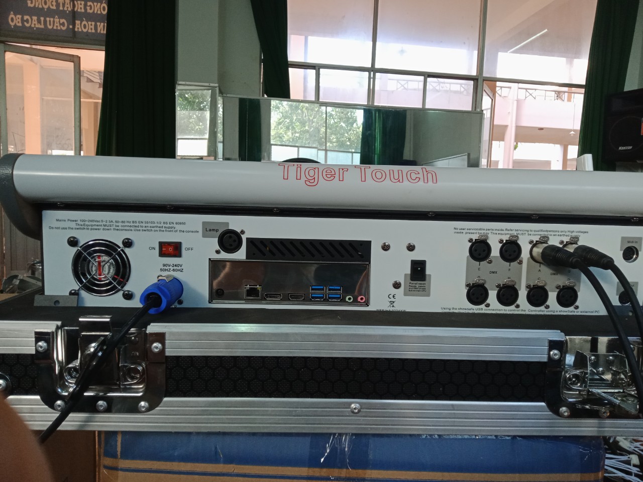

Re: Tiger Touch Help !
My pic
- Attachments
- 2.jpg (245.86 KiB) Viewed 67939 times
- 1.jpg (237.18 KiB) Viewed 67939 times
if I was you - after showing those pictures - I'd better be prepared to answer questions where this console comes from as it is as obvious as a fake can be
mate it's a fake console, you won't get much support for that
sideshowbond wrote:mate it's a fake console, you won't get much support for that
Thank you for letting me know that. how to identify real and fake on a tiger touch console
not gonna go into much detail but if you compare pictures with a real one the DMX connectors give it away pretty instantly.
You should try to get your money back and email ric@avolites.com with details where you got this console from.
One clue
it doesnt say Avolites anywhere on it.
