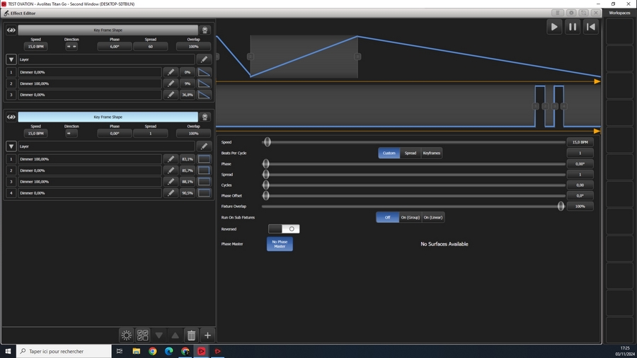

Hi Avo team.
I'm stuck on a problematic.
I would like to create an effect with keyframe that have two dimers state :
The first step is a dimer wave in "center in" direction on my fixture line. At the end of the wave I have two dimer flash on all my ficture line. And i would like to repeat this sequence at infinite.
Wave / FLASH-FLASH / WAVE / FLASH-FLASH ...
But when i built this sequence of two keyframe, only the second keyframe ( two flash light) is running. I understant that the second one is taking priority on the fisrt one. But i would like to tell to Titan that dimer 0% step of the second keyframe is lowered by other dimers intensitys of the first keyframe. Or that highers dimers intensitys in first keyframe takes priority on the second one.
There is a way to manage priority (HTP) between multiple keyframe on a same parameter ?
(I used a chaser and it's working but is more trickky to adjust times. Use curves of keyframe editor window seems more convenient)
Thank you !
