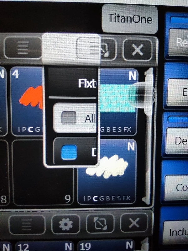

Has anyone every encountered this? The Patch View window opens and is sized in a weirdly small way, but I have no way of making it bigger, or pressing the button to resize it?
It's frustrating, because it's the one thing I really need to see properly, so I get a clear list of all the fixtures and DMX addresses etc.
I'm running Avolite Titan Go software on a Acer touchscreen laptop.
Any help would be great! Thanks in advance!
PS. I have an image of the weirdly small and inaccessible Patch View window (sorry for the image size)...

You can press the VIEW button to open the Window Options menu which includes options to minimise/maximise or toggle the size/position. If you have accidentally set a window size too small you can use these to make the window large enough to display window furniture such as the resize button.
I thought this had been improved so that the resize button is always visible, even with small windows. Which version of Titan are you using?

Pressing F4 on the computer keyboard will also help.
